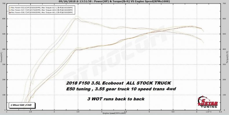

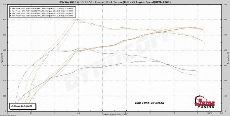

dyno charts from 5 star stock vehicle except for 5 star calibration & E50
Max whp 330 stock---550+ with E50 &calibration (66% increase)
Max whl torque 414 stock---600+ with E50 calibration (45% increase)

Some thoughts why 5* got so much hp & torque from E30 & E50 calibrations
First of all octane rating from that mix is probably close to 100+ octane
The evaporative cooling characteristics of ethanol probably improves charge air desnity
Apparently the HPFP along with the GDI & Port injectors can supply enough fuel to support those hp & torque figures
Apparently there is adequate flow though the stock intake & exhaust systems to support that much power
