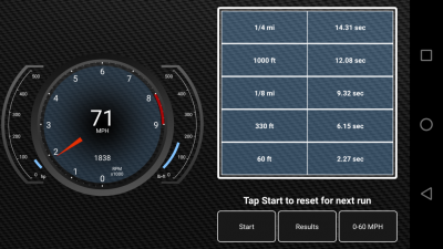

I'm not trying to sell anyone on the OBDLink MX, merely pointing out it is relatively inexpensive, for what can be done with it. As long as you have an Android phone. Not compatible with ANY Apple product, though it is Windows compatible so you can use your laptop with it, or notebook, etc. There's another company that sells something very similar to this but itsi a little over double thatthe cash, that works with IOS...
http://www.ot-2.com
All that being said, I bought mine originally, to have access to read and clear codes on all our vehicles. I am totally NOT saying that it is as accurate as a dynamometer, or timing lights at the dragstrip. I do hope, that it IS at least consistent in the calculations it does provide.
All things equally considered, if I conduct my little "off public highway sorties" at exactly the same area, time after time, with only one change, I suspect/expect the differences to be somewhat indicative of relative progress.Screenshot_20180829-075553.png

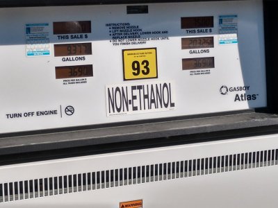

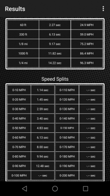

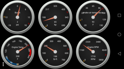

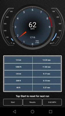

The last pic (in the above prior post) was the first time after filling up with 93 octane, with zero ethanol, with about 2-3 gallons of 87octane with the common 10% ethanol.
The following is after a couple of refuels also 93 octane, with zero ethanol. Note that each of these were done at exactly the same spot, in sport mode, auto start stop off, traction control off, 4wd auto, letting the tranny shift on it's own, not loading the tranny via the brake, and around 5 miles after a dead cold start, with stop and go traffic early in the morning to get to my "spot".
Obviously the hp and tq figures (note where the peak are shown via red arrow indicators) are crank or flywheel computed. The max boost is also interesting, as I've read there is a momentary "over boost" built into the programming for Sport mode of 2-3 lbs for about 10 seconds or so.
If there were 20pounds available all the time, I'd be happy happy happy, to say the least.

Also want to mention...look at the 1000ft marks, more than the 1/4 mile. Reason being, I have no idea where exactly the 1320 foot mark is, from where I start. In all likelihood, I'm already coasting by the time I've passed the 1320 mark, to not draw unwanted attention to myself. I need to take this thing to the dragstrip to find out without any doubt, how quick this party bus is, or is not, before I start swapping parts.
