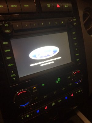

Over the last week I've added factory DVD headrests as well as a factory head unit / radio. I'm using the term "factory" to mean OEM devices that could have come as an option originally, but I paid a lot less installing it, compared to what it would have cost to add it to a new vehicle. That's a moot point anyway, because I bought the vehicle used/ CPO. Anyway, if anyone has any questions or is planning to do the same, let me know. We almost went with a Pioneer HU like we did in my 06EB, but decided to go this route instead.
The only difficulty I ran into was when I was installing the head unit. It requires that a 16 pin "T" adapter harness be installed to "C218(A), which I could not find. After spending a lot of time searching the interweb, I finally found that it was located within the steering column.
Headrests took about 2 hours, and Head Unit took about 2 hours. Probably could do it in about an hour though. 20170211_221303879_iOS.jpg 20170216_001842999_iOS.jpg
