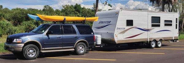

Ristin, I basically have the same truck and trailer combo as you (my 27' trailer is 6450 empty) but mine has the 3.73's and I just went to LT - E rated tires which does make a difference. I also changed my rear shocks to Bilsteins and added Firestone Coil-Rite air bags in my springs. I assume you are using a good weight distribution/anti-sway system, I have the Equal-i-zer 4-point system which works great. I am sure I am right at the truck's towing limit but it does not feel like it at all and tows fine here on flat Florida roads. I don't pass too many gas stations without stopping lol!

Wow we even have the same color truck.

My light denim blue truck looks awful similar with the 30'
