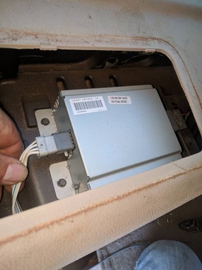

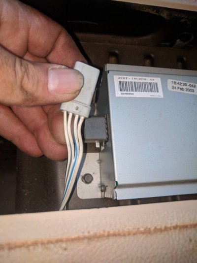

Do u have pictures or know what wires I need to splice from the factory amp to get my signal sound for my Rockford Amp ??
I'm still googling it but sofar no luck.

Oh... Going big! Nice!
I have a Xtant 1010D that I installed under my middle row seats that I use usually now. I wanted more bottom end, and as we all know the factory amp is limited... But, for those of us who just want a little more bottom end, I'd suggest building a small sealed box and install a 10" DVC 2 ohm sub, and its more than enough, for most!

Yeah I wanted to feel the bump so I went with the Rockford 1200.1D amp @1ohm
And a MTX Audio 12" Solo Baric 650rms
2.0 cf Ported box.
It should hit a little harder than the stock.
I'm going to connect to the output side of the stock amp wires for mine in line converter to low pass signal.
The right side of the stock amp I gotta figure out which is the remote turn on. Then tie it to the Rockford Amp..

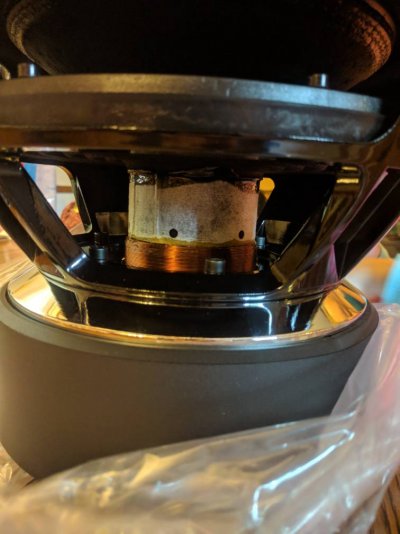

Well that MTX sub lasted about 3 songs and blowed.
So I went bigger and got this
Skar VXF-12-D2 1,500 RMS 3" voice coil
I talked to Skar Audio and they told me that this Sub can take everything that my Rockford Amp could bring.
So I had to redo the mounting surface on my box to go from a square sub to a round sub.faa1f3f2897bea52b02c6de770668003.jpg42669332a9a0923f51c47bc6993e6236.jpgfa464aa3240004c436d1253721f482ff.jpg3a5333faf2eb37c13d4fe6dcf15b7fb8.jpgf003d50e650bfe1e9a00410d1ca69131.jpg

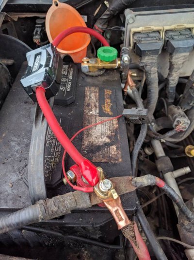

Hey brother I got this mess going on with to many battery terminals going to the Hot post on my battery. And every time I open my hood I keep saying Man I gotta do something with that mess..lol
Do u have any suggestions or a link to a battery post terminal junction block that would accommodate this many wire's.?
Auto Zone and other store only have a block that accepts like 2 wires with set screw's.
I couldn't find nothing on Crutchfield Audio website.

1955moose
Nov 23, 2014
6,004
1,351
Go to Crutchfield.com. They have all the connectors you'll need to run multiple hot leads. They also give great free advice.

I did and didn't see anything that would accept 4 to 5 , 8 gauge wires.

When I used to run multiple amps, I'd run a 0-2 gauge wire to the battery, then a plastic battery divider that took up to o gauge coming in and 4- 6 gauge Allen screws on other side. If your running monster current amps that need bigger than 6 gauge, you'll need something bigger, they make them. Check with a car stereo install/sales shop in your town. How big is the wire coming off your biggest amps?

Thanks for your time.
Currently I only got 1 Amp Rockford 1200.1
Pushing a single Skar VXF-12-D2 sub.
I'm using the recommended hot n ground wire for the Amp 4 gauge .
I guess the easiest thing to do is make a buss bar with 4 or 5 posts .
I'm not sure how many amp it's pulling but Rockford recommend using a 100amp fuse off the battery post for this amp so that's what I got.

why do you need it to except 4 to 5 8 gauge wires? I use a "stock" terminal with each other the copper screw down terminals on each side, along with the starter wire and my 6 gauge under the main spot to "crimp" the wire, works perfect.

Don't forget 6 gauge is good for 60 amps, 4 for 100, and 2 for 150 amps, and 0/1 for 200. I have an old school Orion HCCA 225 bridged on a pair of newer Kicker 12's, I have never had a fuse fail. And, those who know, will know how powerful my amp is(was laying around so why buy something else, when it doesn't get any better than an Orion?
