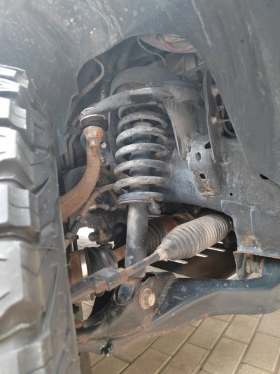

Anyone else installed F150 front shocks and springs on a Gen 3 Expedition. My car is a 2012 and it was a straight replacement.
Rear suspension is lifted with a 2 inch Rough Country spacer.
New wheels and tyres 33's.
4to 5 inch lift front and 3 to 4 inch rear with trues.

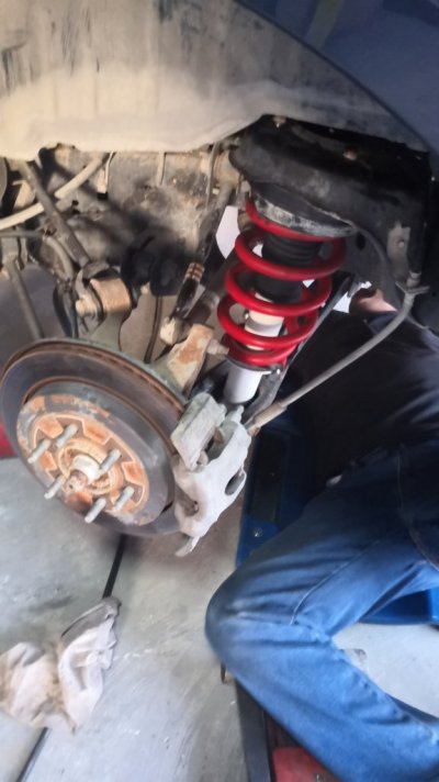

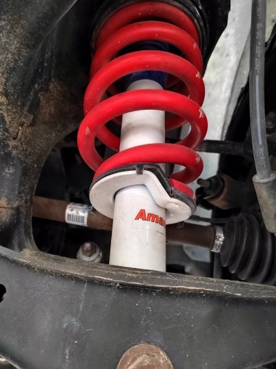

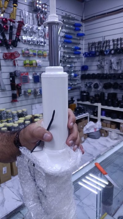

Thought I'd share, just had the rear shock replaced, very difficult to find any to fit and Blistien seems. To be the way to go...... Until I came accross these which are a huge beefy upgrade
Amada Xtreme brand? Straight swap but a much heavier build quality
Finding shocks to fit is a challenge, anyone else come. Across this brand. From Thailand? http://amadaxtreme.com/

Never heard of them but they look nice. How's the ride quality so far?
Definitely give a report on them after 6-12 months of use. Having options is a good thing :)
