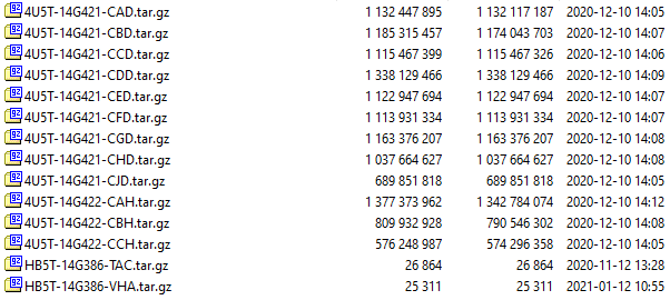

This a screenshot of the files downloaded from Ford's Sync Nav update site downloaded today using a 2021 Expedition & 2020 Expedition VIN(Same files for both). You will notice the file date. These are the same files that have been available for over a year. 2/2020(2nd half 2020)...as I expected. If there is newer Map data to be had for Ford Sync 3, it is not publicly known about, being distributed by Ford, or available via Cyanlabs updater.
