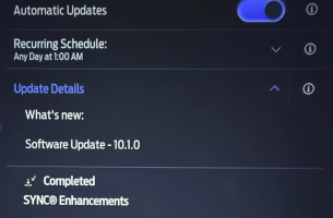

A couple weeks later now and my vehicle said "Update Available" again. I clicked "UPDATE" and it said "Downloading..." for some hours w/o completion and so I decided to set a Schedule for "after 1AM" and also set "Automatically Update" to ON. Well, this morning sez "Update Successful" and it's reported that this update to SYNC4 10.1.0 changed my truck's software from 24058 Revision 1197 to now 24127 Revision 1270. So am I now updated to latest?
Having read @rugedraw your posts about "can't predict when Ford will send updates" I guess I shouldn't be shocked that it took this long but still.
I had left Auto Update OFF because I WANT TO KNOW when updates appear and what they are and I like to check online if folks have probs and etc but it seems Ford is foiling me. In the end I remain disturbed that their system does not 1. ALERT me to the need for an update, and then 2. That it doesn't ADVISE me that the update has occurred successfully i.e. via email or app notification.
EDIT: Now I see on ford.com the following: "Important: If Automatic Updates and Notifications are off, your vehicle will not receive any updates. This means your vehicle will not receive any new features or critical updates via Software Updates." which may explain why it didn't Update when I first asked for same. Still, the display stayed at "Downloading..." and should have instead said TURN ME ON DAMMIT.

Was out on vaca and just saw this. According to Ford, Sync 24127 is the latest available for these trucks (my F150 is on the same version and this is also the latest version for many other Ford vehicle platforms). This is an APIM update and installs while the vehicle is on and running; not using the auto-updates schedule. When an update installs, you are SUPPOSED to get a notification on both your touchscreen and in the Fordpass app, but the system is less than perfect and this does not always happen.
Even if you have auto-updates turned off, if an OTA gets queued up for your truck, you will get the notification on your touchscreen about it. I have it turned off because I have a pending PCM update on my truck that Ford has tried to push to me a few times and I don't want it to wipe my tune. Because I update my truck myself, that is the only update I have pending so I keep auto-updates off because if I were to get sent an update, I know exactly which one it is and I don't want it.
