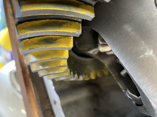

UPDATE: I got the oil baffle and all bearings and seals installed, but the original differential carrier shims are way tighter going in now. I am struggling to get the carrier installed with the shims, has anyone done that before and have some tips?
P
PlorkZ47
Sep 1, 2025
Florida
update: I got the backlash dialed in at 0.006” and the attached pictures are my gear pattern, I think it looks pretty good but I’m looking for anyone’s thoughts on it. My only concern is the amount of preload on the carrier bearings, I’m at 4 or 5 in-lbs more than the pinion preload, if I’m using the right calculations that’s at or just below the minimum range of 16 to 24 in-lbs calculated preload on the carrier, does that seem right? Thank you.IMG_5453.jpegIMG_5454.jpeg
