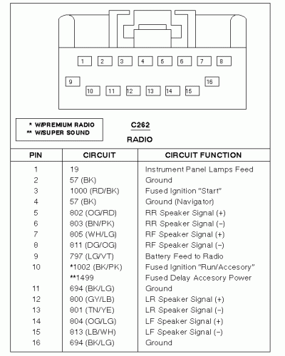

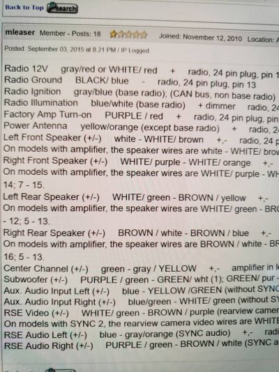

Your simplest manner is to take the door card off, and just reverse the wires. If it sounds clear, then you've found your culprit. You can also look up the wiring diagram for the 08 Navi, and check them. There are sets of speaker connectors out there that are actually wired backwards, and have to be reversed. How do I know? I have 2 sets that had that very problem. Metra and Scosche both had their Ford speaker connectors reversed. I'm attaching the two I refer to in my 2016 expi. They may, or may not apply to the Navi., But as long as the wire colors match, you're heading in the right direction.449e50b52762567041ccdee77bfaef4f.jpgc385546bb7b91293a92660490f9fa9b9.gif
