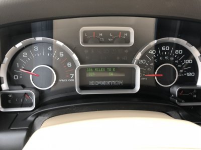

The last few times I’ve stopped to get gas the expy is only taking roughly $68 worth in fuel and it clicks off, even if I add a few more clicks the fuel gauge is below full and reads less miles to E than normally. It’s a Minor annoyance. Does not click off mid fill just toward end but I can’t pack it full like normally. Any ideas on why it won’t take that last two or three gallons it used to? Never normally add after that initial click but with it not taking enough gas I’ve been adding after anyway.
I don’t believe it’s a float problem, as the pump reflects the same results of less fuel than normal.
Not a huge deal just has my curiosity peaked. Could just be a fluke.

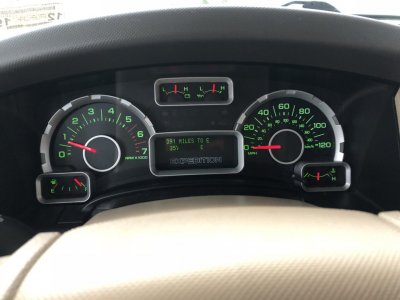

This is after filling up:
Normally 425 miles to E.

I don’t and after thinking about it you are probably correct on fuel level sensor. The vehicle likely has more gas than it thinks when it comes down on E fooling me into thinking it’s actually empty. I’ll see if it corrects itself..... not sure if it’s something I should live with or not...
