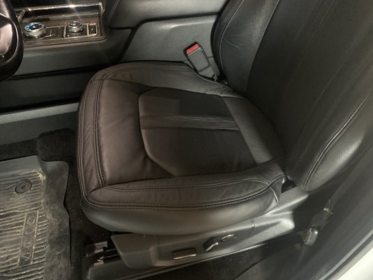

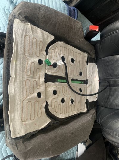

Seat rebuild went well. Apparently a heavy hitter owned this. There was broken clips, frame pushed through the foam on the outer bolster, bolster disintegrating and a split in the side of the cover.

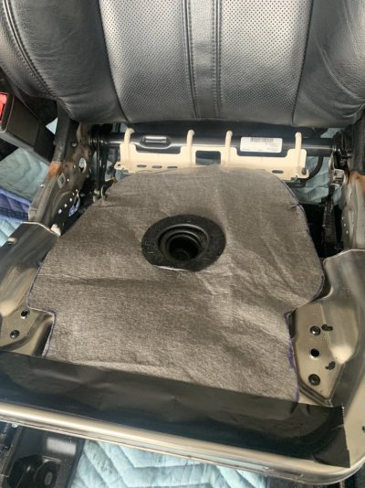

I glued the split together, added material to get the bolster back to the correct height, sanded it to shape, @reinforced the clips, added woven polyurethane to prevent the frame from compromising the foam and added another layer over the springs. New cover installed, 100% better.
