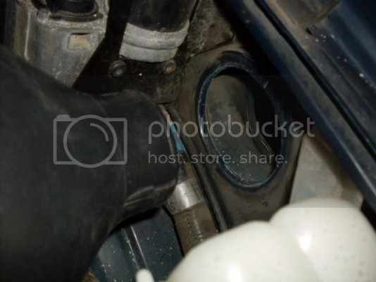

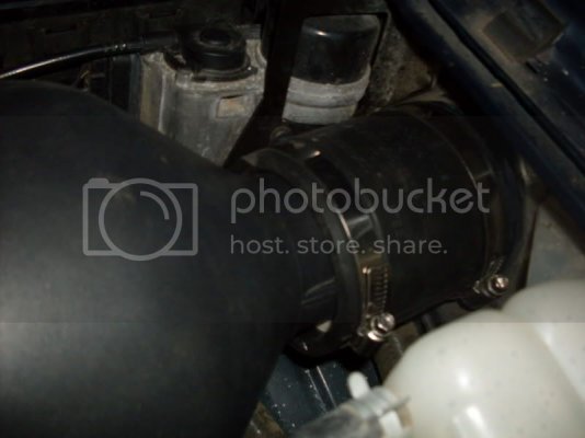

i dont get what this is doing. can someone explain. also what do you use to do this?
Haha. I knew something wasn't right when I tried pushing that thing in for like 15 mins. i dont get what this is doing. can someone explain. also what do you use to do this?

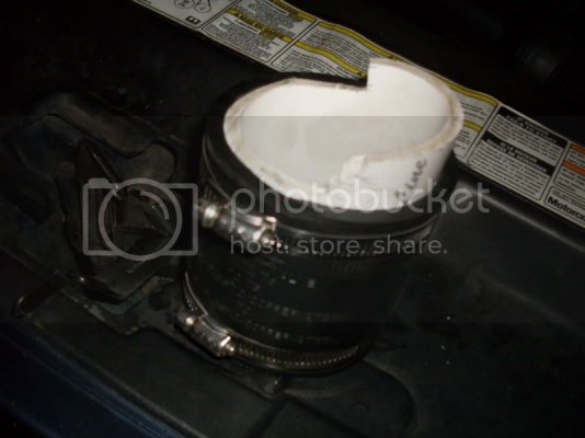

using a thin wall 3 inch exhaust tube works alot better then pvc. I tried using the pvc pipe but after 1 hour of sanding I lost patience with the plastic and just bought a exhaust pipe and stuffed that in the hole, it was alot easier to force the exhaust tube in place then it was with the pvc pipe and it required no filing or sanding lol
