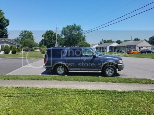

Hey guys, I'm pretty much going to give a run down on why I chose this platform and what my intentions are.
I researched and shopped for about 6 months for a truck or SUV that fits my needs. 4 doors, rear seats (I have 2 kids and a doggo), 4x4, easy to find replacement parts, known reliability, offroad capability but good road manners...so solid rear axle and IFS fit the bill. I looked at K1500 trucks SUVs, Sport Tracs, Exploders (Gen 1 and 2), Expeditions and Tacos and 4runners. Immediately I found the Toyotas were not for me, let me explain. They are without a doubt the worlds best out of the box ready to mod offroaders. I wont deny that, or that they are known for unnatural reliability. BUT, they are also know for catastrophic rust and Toyota Tax. Seriously, why pay $7k for a Toyota when I can get a comparable american made truck for $2k?! My Toyota friends are still in denial about my findings.

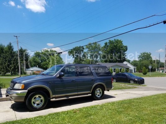

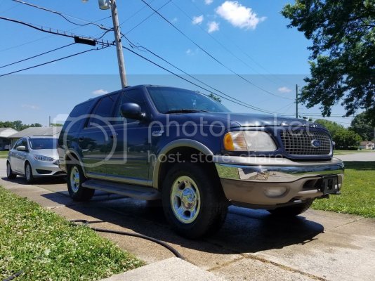

So a friend of mine bought this truck at auction, and I told him I'd buy it. He gave me the friend price and I offered him a trade for my 2001 C320. Keep in mind I have $1250 in to the Mercedes. We straight traded and I ended up with a 2001 Expedition EB with 159k on the clock. Sold frame, solid rockers, everything works as it should, good tires. Needs a few minor things like new hatch glass hinges and sunroof linkage, but I'm not concerned.

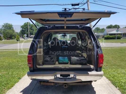

The goal is to get the maintenance up on it, service the diffs, go ahead and do the dreaded spark plugs, suspension bushings, air to coil plus 2.5in lift. After I get some miles on it I want to add a second full size battery under the hood, hardwire my power inverter, full interior LED conversion, build a short box in the rear to hold drawers for my camp stove, "kitchen sink" and other supplies that I can also roll my sleeping bags out on. I'll likely tent camp if the entire family is with me, but for 2 people there is plenty of space in the truck.
So far I've removed the factory amp and sub, I didn't waste any time diagnosing the issue. Installed new amp where sub was, and just put a single 10" Alpine type R in for now. I'll change it up when I get serious about building the rear set up. I've manually aired up the rear suspension and turned the air ride off. The pump leaks. It'll be slow progress but making a thread helps me keep track of my own build.

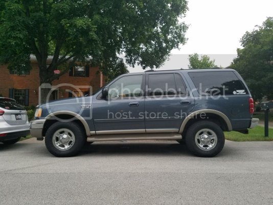

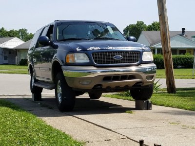

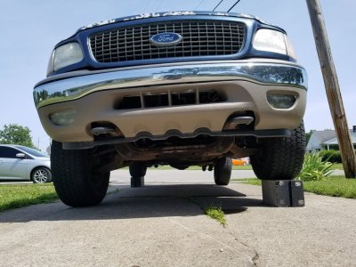

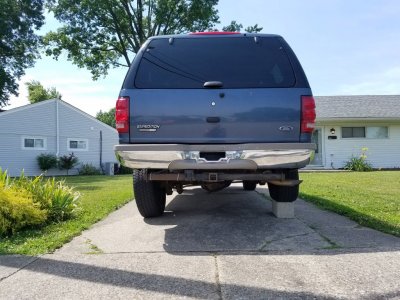

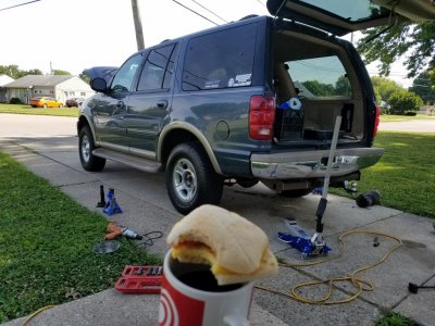

Spring conversion and lift is on! Still waiting on shocks. Tubular lower control arms are on the way as well. Parts I have sitting aside for future are:
Dana 50
Sterling 10.5
ZF6

Some wheels on blocks on an incline, anyone else find that kinda scary?
