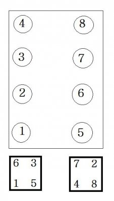

Are 4,6,8 on the same coil pack (I don't have COP's)? Might as well change both since I have 218k on it....

I would stick with the coils as I stated earlier. Or you have some wires misrouted after you installed the new plugs.
And to answer your question concerning the spark plug location relative to the coils.
