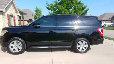

New to the forum! My wife bought a brand new 2018 Expedition XLT yesterday, and it is fully loaded with every option a XLT has to offer. I could not see spending an extra $10,000 just to get LED headlights and Captain chairs on a limited Expedition. The only problem I have seen that I'm not happy with are the headlights. I've looked through the Forum and have not found anything about changing the lights. I talked to the dealer and they have tried to put the limited headlights on an XLT but could not make it work due to different voltage. What options do we have for LEDs or HIDs. The lights are projection but are not bright, and they are yellow. It is pretty sad that the basic small SUVs have led options.Resized_20180510_171556.jpg All help is greatly appreciated!
