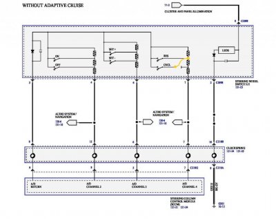

Left side works almost perfectly...1 exception...the resume and cancel for cruise.
Push the Resume button once...it cancels Cruise...push it again and it Resumes Cruise.
Cancel button does nothing.
It’s operation is like original Expy switch...1 button does both Cancel and Resume.

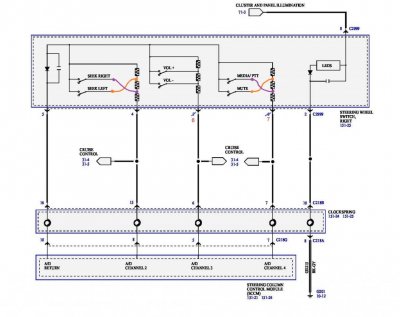

Right side was a little more complicated...I had to swap two pins on the right switch connector on the steering wheel to get full functions...with the following exceptions:
In order from right to left...
Volume switch works perfect.
Voice command switch is opposite...push mute to talk and vice versa.
Seek switch is opposite...push up, the seek goes down and vice versa.
These are all quirks I can live with for now...until I need another project :)
If one could modify the circuitoards inside the switches like such, that would work right ?
These are the 2016-2018 ford explorer diagrams

I think so, yes, but I'd still like to know the exact resistance values involved just to be sure.

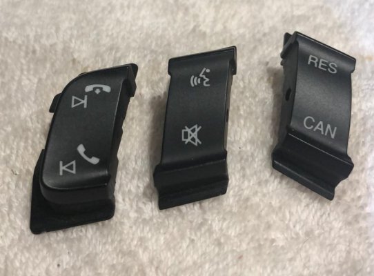

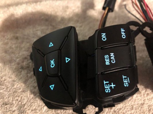

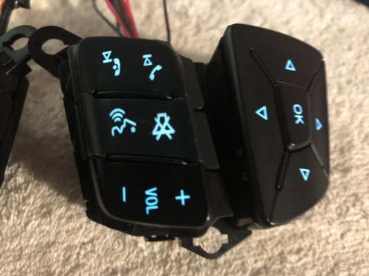

I found a guy that was able to re-label the switches for me.
First, I removed the individual pieces from the Switch Assemblies
Sanded them off, repainted them black completely.
Re-created the logos with no background. Sent the files off to the guy. He loaded the files in his software and laser etched them.
Came out looking very very decent

This is FANTASTIC!!! I happen to have my own laser-cutter so I must try this! You can do it for just about any switch that can be disassembled. The only issue is the durability of the paint. It's probably best to apply several coats and let them cure very thoroughly before installation.
