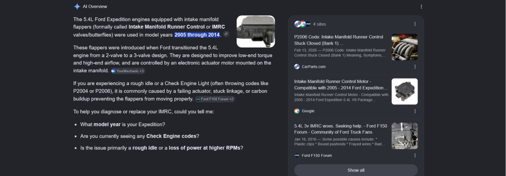

Does the 2012 have variable length intake runners??
That I don't know... The intake manifold is pretty well buried beneath covers, throttle body, etc. I could probably find out through some research. What's your thought???

The intake manifold is pretty well buried beneath covers, throttle body, etc. so (I) certainly can't tell by looking at it but could probably find out through research... What's your thought??
I am thinking that your manifold may have active runners and you are hearing a tonal change with throttle and load setting as the manifold switches between short and long runners, Like a wind instrument with valves. You might temporarily pull the electrical connector from the actuator to see if the noise changes. Since you have no issues with drivability, emissions or any codes, it is probably normal.
