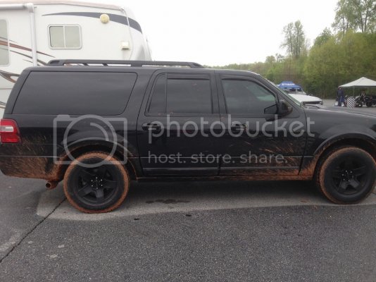

I agree with motorkas definitely wrap your door handles. I did mine in a 3M vinyl that is carbon fiber and love the look. I did plasti-dip the emblems and the roof rack and have had no issues. I just made sure they were clean and then I used the 3M 94 primer on them and used about three coats of dip to them and they have been through multiple car washes with no wear. I wrapped the back chrome piece as well.
Take a look at my pics to see more detail.
