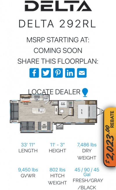

Hi all! We’re thinking of purchasing a 2022 Timberline and using it to tow an Alliance Delta 292RL. There will be two of us & 3 dogs riding in the Timberline, totaling just under 650lbs. Do you think the Timberline can handle it with ease?
Thanks in advance!

That's a lot of trailer for an Expedition. You'd be a bit over the specified maximum limits. Will it tow it? Sure it will tow it. But not with ease, that's a Super Duty level trailer imo.
