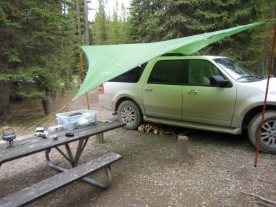

I've camped in my Expy for up to 9 days in a row where it gets below freezing at night. I have "clothes, hat, gloves" I wear in my sleeping bag and a blanket over the bag if I need that. Toasty warm. Until I have to get up and go outside for relief. Here is a nice addition I use on the side of the Expy for when its raining or protection from sun. I've never figured any safe way to heat the inside of the Expy so I would have no use for insulation. I used to have a cargo van that I spray foamed the floor, walls, ceiling ... and it was NICE to have that. We would get a few people in there (70's) and body heat was enough to keep it warm inside. Of course you may be trying to keep heat out not in?
