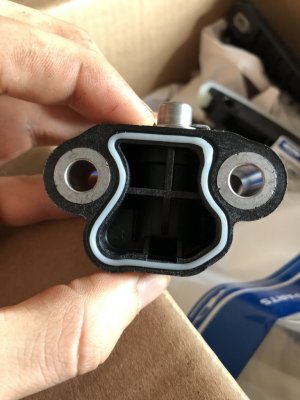

I changed the engine oil and manually cleaned the fuel injectors yesterday and that didn't help my issue. But when I emptied my catch pan today I found alot of fine metal shavings and some bigger pieces. My plan is to pull the valve covers and inspect the followers and cams.

I found one bad lash adjuster and both timing chain tensioners are blown out. I'll pull the front cover tomorrow and go from there.
