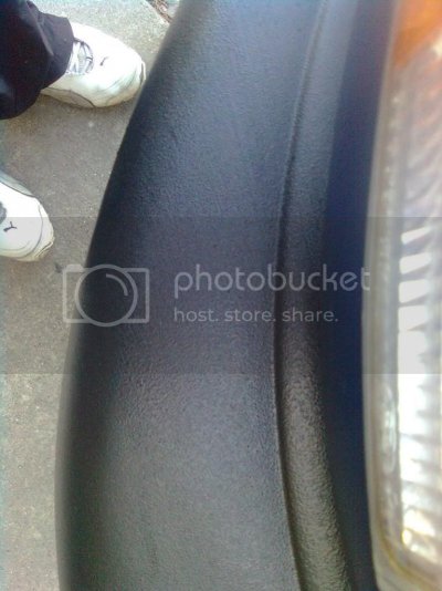

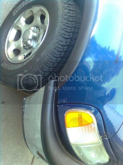

ok ill probally have pictures tmrw but as it stands TAKE OFF THE FENDERS COMPLETELY!!!!!! DONT LEAVE THEM ON THE BEDLINER WILL PEAL OFF!! haha that just happened to me so i yanked em! you remove the 4 visible bolts and you have a little plug at the bottom of the fender closest to the front doors that you gotta remove, start pulling from the bottom and you will figure out the rest lol.
on a side note the first can of spray on bedliner i had completely hardened in the can! lol that sucked!
jacks3am
Jul 28, 2010
1,192
michigan

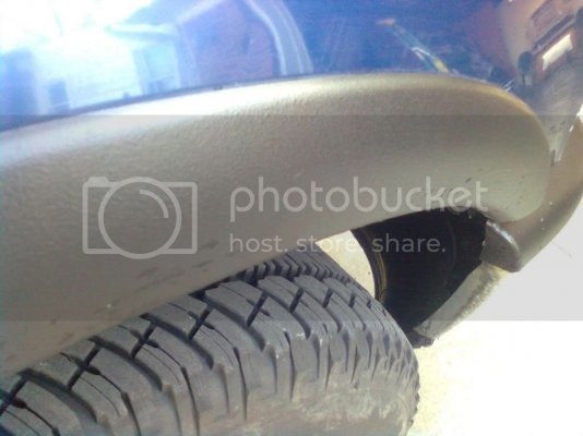

i know the pictures suck, but theyre the best i could get of the texture
the white stuff is car wash soap
one last thing,if you keep them on, you can do it but when removing the tape, use a boxcutter or exacto knife and where the tape meets the fender start slicing because if you dont it will peel off

In one pic it almost looked like a dark grey, I guess it was just the light. Looks pretty good, I am thinking about doing something similar in tan.
