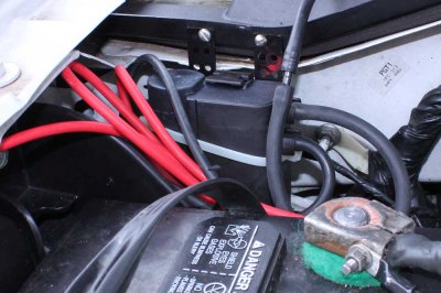

Ordered and received a Alpha Therm AT- 38- OD windshield fluid heater, and installed it in about a 1/2 hour's time.
Works great, can't wait to see how it helps on cold snowy mornings.
Perfect spot for it just outboard of the engine computer. When I get inspired, I will trim the wires.
Maybe some action shots on a cold morning? Should look like the de-icing operation on the ramp at the airport!

I took another look at your pic, is that sandwiched between the battery and firewall?

Yes. I through bolted to the lip of the plastic cowl cover (wiper linkage cover) because I HATE drilling into metal going into salt season. The unit is not that heavy, so it should not stress anything.
The wire is at least 8 gauge, and about 2 feet or so too long. I just coiled it up and zip tied it out of the way for now.
The unit draws about 50 amps once you start the vehicle. It senses when the voltage is over 13 volts, which is what it uses to sense when the car is running. After it is heated, it draws much less current, on the order of an amp or two to keep it up to temp.
Full heated shot is available about 40 seconds after the car is started.
