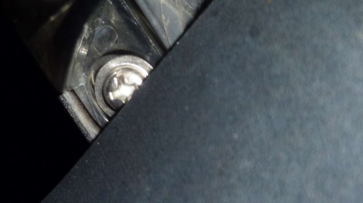

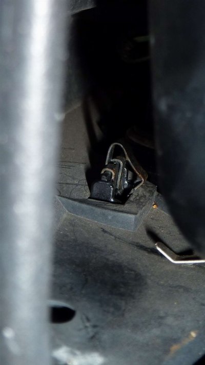

There's a phillips head screw to remove. You can access it by folding the mirror housing back to expose the screw head ( DO NOT Remove the mirror glass...). Then you move the mirror glass outer edge to get behind the glass and with a longish flat screw driver manipulate the spring clip that holds the turn signal housing up in the housing. Push it skinny so it'll pass through the hole and drop the turn signal.

Use a long flat screw driver to compress this spring clip to pass down through the hole....
Fold the mirror housing to access this phillips screw ....
