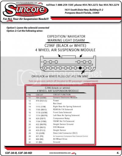

How to: Disable the Air Ride Message center (Coil Conversion)

I retrieved this info from Suncore Industries.
How To Disarm The Warning Air Suspension Light in Ford Expedition and Lincoln Navigator 1997-2002

you are the man! Just wish it was for an 03-06.
You may want to look at your female harness plug and see if the color coding is the same, we are talking one year difference, and that 1 yr could be hugh in difference, but then again it may not.
