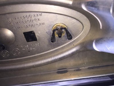

Does anybody have any advice on how to remove the front ford emblem off the grill of a 2009 Ford expedition? this is the original emblem it does not have the adhesive on the back. It looks like it should just pop off if you pry open the clips on the grill picture enclose. I have the fasteners off already.

I figured it out myself
Need a 10 mm socket wrench to take the fasteners off the back of the emblem and then use a pair of wire cutters to snap off the plastic stems. And it will pop off assume it is the original factory emblem without the adhesive backing.
