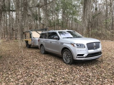

I starting to think about a more rugged wheel/tire setup. I know there are a ton of threads on here already that I’ve read but one thing I can’t seem to find any concrete opinions on is 18 inch vs 20 inch wheels. I don’t want to change the outer diameter of the stock tire I currently run and I don’t want to have any tire running or run a lift. I just want something that I can run through some mud if I encounter it and have more confidence off road in general. I don’t want to rock crawl but I also know that theses stock street tires aren’t good for much past dirt/gravel.

The Nitto Ridge Grapplers seem to get the respect of both slight off-road and on road comfort.
As far as a smaller rim/wheel, you would just need to be cognizant of any suspension the smaller size would impact. Maybe a moot point, but still need to be considered.

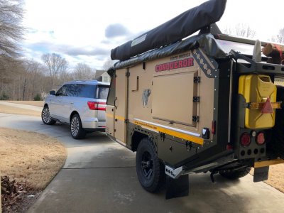

Love it. Quite jealous. Both of your rig and that you have a wife that's interested in joining you on adventures that would necessitate a set up like that. Haha

Smaller wheels will give you a softer side wall that would be beneficial offroad but be careful, you might like the ride so much you want to ditch the 22's. 18's will let you air down a bit to enhance traction and further help smooth out the ride on bumpy washboard roads. You could get some black wheels to better match the trailer wheels pull the look together.
I don't think you need a mud tire, this is a giant suv with pretty minimal ground clearance, avoid any mud more than a few inches deep! I would look at the Dueler AT, Wrangler AT with kevlar, Duratrac (slightly more aggressive), Falken Wildpeak AT, Open country AT2, BFG AT KO2
