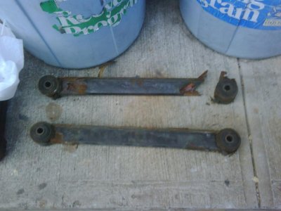

i changed mine aswell. one day was reversing and heard a pop. didnt think anything of it till i actually looked underneath and saw the control arm on driver side broken
I actually took a piece of wood and jacked the tank up ever so gentle and wiggled that dam bolt out. it took me a while but i got it done. i bought some boxed out arms w/ poly bushings off ebay and i love them.
