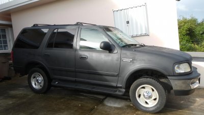

1998 Ford Expedition (AKA the urban assault vehicle) with 150,000 on the clock. I replaced the shocks about a week ago, figuring that would cure some of the handling ills with the vehicle (and it did) however now it has it in it's mind that it's not happy with a new set of shocks.
Latest behavior, even at idle plus speeds it feels like it is wallowing in the back, almost like there is one broken control arm. I have not gotten under there to look yet (I will in about 10 minutes.) However does anyone else have any ideas. The vibration seems to decrease with speed, but it just may be getting masked. Like I said, it feels like it is wallowing in the rear, even at 5-10 MPH, very pronounced shimmying feeling. I'm concerned because I know if the arms break it could be quite nasty for me (and that's coming from someone with a bunch of experience wrecking and racing). I like racing, prefer not to wreck!
Looking forward to your input. This thing is a mess, but it runs fantastic for a $2300 truck (motor seems solid). One last thing, it has been in a high salt environment it's entire life (Island of Guam), so I am expecting something broken/corroded beyond repair.
Mark
