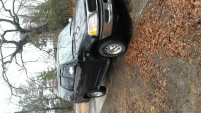

Okay, So I may have made a fools mistake. I went to the auto auction this weekend and picked up a beautiful 97 Ford Expedition XLT (Yes, she is a 4x4). Clean interior and exterior but to be honest, I did not expect to get the first vehicle I bidded on. I thought I'd use her for practice (I only bidded once); thankfully, she was one of four I was interested in.

So good news, it was the transfer motor, it was horribly corroded, she was locked in 4 wheel drive. She needed new brakes and rotors on three of the four tires but of course we did all 4. Other than that she's running 500 percent better. Oh wait she is getting a new starter and seloniod today. She might need her spark plugs changed, oil change, air filter, oil filter, and fuel filter the easy stuff from here. Everything should be ready to pick up from advanced today. Thank you for all your advice.

i would also run some fuel cleaner/stabilizer etc. through your first few tanks of gas in concert with your tune up.
welcome aboard & post some pics when you get a chance.
