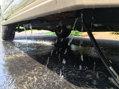

- Rocker panels severe rust (even though the truck is washed at least weekly and immediately after roads salted/cleared)
My opinion on the Rocker Rust is that you can wash until you are blue in the face and it doesnt prevent rust from the inside of the RP. There's holes on the underside / inside that let road salt in where it goes to work 24 hrs a day. Washing does nothing to clear that out.
You have to get at it preemptively and keep the corrosion from starting. To test my theory, and avoid rust (hopefully) first I flushed out the inside of the RP in the spring & then I did Krown treatment. Now (fall) I'm getting ready do another round of spraying more anti-corrosion barrier (Fluid Film) inside there. I'm working on how to seal up the big holes (gorilla tape, rubber plugs, various ideas). In the spring I'll open up the holes, flush it out again and redo the process. This test will take years to see if it helps. Can't wait!
You cant fully seal that off ... so at the very least an annual flush & coat will be the main defense. I dont like rust.
