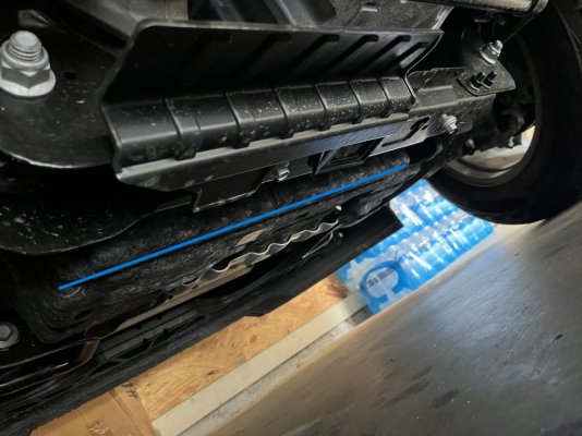

I finally figured out how to attach a photo but not a video. Hope this will be helpful.

Is it an audible rattle or a rattling sensation in the steering wheel? I came from a 2024 Tundra and compared to that, I get a rattling feeling in the steering wheel. I had a 2013 F-150 that felt similar so I assumed it was just Ford being Ford.
I have the same rattle clanking feeling in the steering wheel when going over bumps. I thought I was going crazy. Glad I’m not the only one.

Yes, the rattle can be felt in the steering wheel. Under the front axles is a loose fiber glass/plastic under shield that is not anchored. It can be moved with your fingers. I am waiting on Ford to determine the solution. I just hope more 2025 Expedition owners learn about this before the expiration of the warranty. The offending piece is marked with the blue line.

I know the shop manager checked three other 2025 Exp on the lot and they all did it. It is not a pronounced rattle. If you can look under the front axle and see if you can locate the under shield in this photo and use your fingers to move it up and down. It is hard to hear with the road noise and radio. Mostly at low speed and it is a very low rattle. I will see if I can post the video on some medium so you all can access the video. The forum will not let me upload the video.

Have you reported it to your dealer? Just got a text from my dealer's service manager and they had submitted a report to FMC but have heard nothing from them. I am afraid folks are not hearing the rattle and will not seek a solution until after the warranty expires. The more folks reporting this the faster FMC will find a solution. It is a fiberglass under shield that is not secured. My dealer advised there was no factory suggested solution yet. I have called the 800-392-3673 three times to report it and follow up.
Was told a few minutes ago to take the vehicle back to the dealer and have them diagnose the problem and call the above 800 number back and they will escalate this to someone somewhere else and then start working with the dealer. If you can reach under the vehicle, the under shield can be jostled with your finger to make the noise you are hearing. Good luck.

okay, I went out and checked out the fiberglass shield on my '25 Expy Max. It does move up and down towards the front of the vehicle, where the shield rests on top of another aluminum shield/cover of some sort. I can press the fiberglass shield up and it freely moves up and down, and I suppose someone might hear a sound when moving over bumps. Seems like it would have to be a significant bump to hear a sound from the fiberglass shield moving up and then falling back down on the aluminum shield/cover. I don't hear it while driving my truck, and at least on my vehicle, that movement would cause no problem whatsoever, except possibly to someone's ears (not sure how possible with engine noise, tire noise, wind noise, stereo, etc.)
Anyway, if that bothered me, I would simply add some kind of damper between the fiberglass shield and the aluminum shield/cover. A piece of foam, like weatherstrip, adhered to the top of the aluminum piece would stop any possible noise.
having said al that, maybe the OP has a different problem. None of the fasteners on my fiberglass shield are loose at all. The fiberglass piece itself is free to move up and down (towards the front of the truck), and that is clearly by design. So maybe the OP has a loose fastener somewhere, but otherwise, I fail to see the problem, and certainly do not hear anything and if I did, and if it bothered me, It literally would take me 30 seconds to wipe the top of the aluminum piece clean and stick some weather strip there, between the flexing fiberglass piece above and the fixed aluminum piece below.

The shop removed the undershield and the rattle was still making the noise. Drove the shop manager around and he heard it. It is noticeable at about 10-15 MPH. They took the vehicle for appr two weeks. Called advised could not replicate the noise-then drove a mechanic around and he heard the noise-thought it was a strut. Vehicle stayed in the shop from about Oct 9-Nov 26 while the strut was on backorder. Took the car over Thanksgiving to Texas-got back and shop got it on Monday-the strut arrived and i got the car a few days later.
Still has the rattle-took the shop manager on another ride and he heard the noise and has no idea what it could be. Waiting on them to schedule a return date for them to put hearing devices under it to pinpoint the location. Had the car 7 months and it has been in the shop for an approximately 75 days. The dealer has been great about trying to find the problem and making sure I have a courtesy vehicle. I have been in contact with the 800 folks and asked for Buy Back. Has anyone participated in a factory buy back of a defective vehicle? Stay tuned
