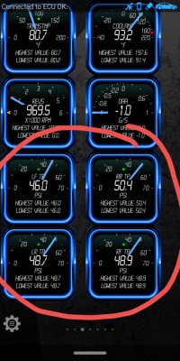

Torque pro app can read the info from the vehicle. Just need an OBD dongle.

The truck already has the capability. Install the Torque Pro Android/iOS app and an ELM327 adapter (available from Amazon).

You are correct. There's no option for it in the gauges, but the vehicle has the info. I don't know why Ford didn't provide an option to display it in the cluster.

It's there in the info, read post # 4. I don't know why anybody would want it but if you don't have it there would be a light and text on your cluster.
