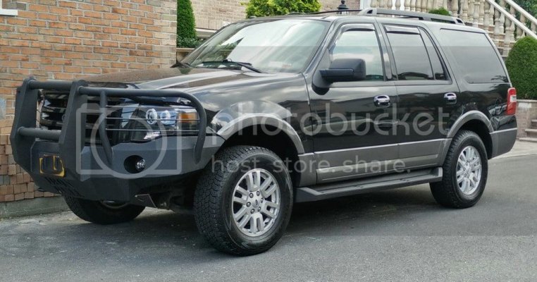

I would not do this again. Bolts right up but fit and finish is not there. Had to go shopping all around for other parts to get it together. And the part to support the FORD Grille does not fit.
No documentation, and no where to really secure the rubber flap behind the bumper.
Left and right sides of bumper aren't built the same.
The area right above where i have my tow hooks protrudes a different amount.
The spacing and gap around headlights is off by as much as 1/2" on both sides
But asides form this crap, it does look half decent.
I also have RCI metalworks skid plates installed. They are marketed as for f150, but all you need to buy is 2x 10mm Long U nut and 2x 10mm bolts and it'll mount right up with a factory look/no drill.
Running JW Speaker 6150 fog lights

thats going to be hard, i've had this sitting around for half a year hah. I sent them a whole slew of pics that i will eventually post after i resize them.
Pretty shoddy stuff, like they just built it without any measurements

latest picture, bumper is starting to grow on me.
running the ironbull bumper, rci skid plates, jw speaker fog lights. vehicle is leveled with rancho quicklift loaded. will monstaliner the silver trim pieces soon.
