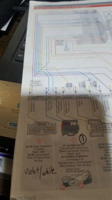

I installed a Fortin remote start on my 2014 expy. Cost $99 for module, and $ 40 for flash tool. Works off existing remote. You hit lock button 3 times. I installed myself. Works great. Glad I did..
