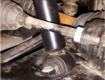

I am going to get to the bottom of this and so far I am pretty optimistic I won't have to get KYBs.
I thought the bottom mount was different as well.
Turns out that this is the case on the front but I do not forsee that being an issue.
The 07-13 utilize a single bolt and nut that go through the side of the control arm and shock eyelet.
The 15-17 utilize a pin with plates on each side and then are secured vertically in the control arms with 2 bolts. The shock eyelet is the same the pin is just inserted through instead of the single bolt and 2 bolts connect to that. So I should be able to reuse that pin from my factory shock.
At this point I am 95% positive that if I am able to get a set of the lower spring perches from a 07-13 that the rear Bilsteins will work without any issue.
All the rear part numbers across the board are identical for folks that make them for the 15-17s. That includes Motorcraft, Napa, KYB, and Monroe (pretty sure they make Napa) and of course all the specs. are the same per brand.
The front is where we come up with the differences that I can locate comparing my truck to videos and part numbers and part specifications that I can find. The specs are slightly different and to lower mount style but as pointed out I don't think that will be an issue.
