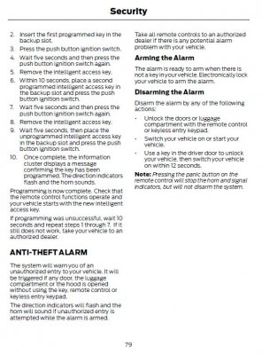

Out of curiosity - I checked Ford’s online owner’s manual for the 2019 Expedition. Instructions were included on page 81 on how the owner can program an additional intelligent key.

DIY *if you have two programmed fobs*.
I personally did this when I took ownership of my 2019. Locksmith on eBay sells OEM like new fobs for $49 and new key cut for $20. You send a pic of your key. With two existing fobs you can program a third or fourth. (Owners manual has the steps to follow and took about 5 min)

Yes, but if you only have one official key, it has to be done with a scanner. Ace hardware can clone you a key for $50, but it can't be used to program another one with the two-key method.

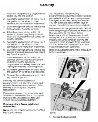

Uh, Village Idiot here--what exactly is the "backup slot"? Is it a hole under one of the front console cupholders? Does it have any other use/function? I've got a 2020 Expedition EL Limited with pushbutton start....
Uturn
Jul 12, 2018
294
140
The backup slot is under the rubber insert in the front cup holder. I t has two functions that I am aware of. You can use it to program a spare key if you have two existing keys and if your key fob is dead and will not communicate with the vehicle you can drop it into the backup slot and the vehicle will start.
