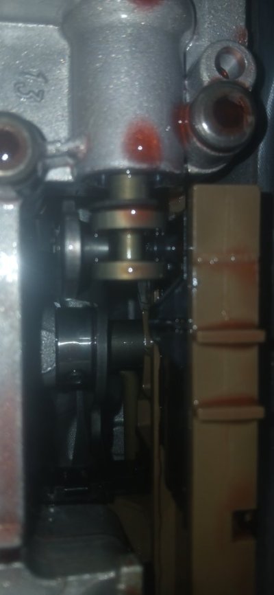

Can anyone please help me figure out why after replacing my molded lead frame in my 2014 ford expedition limited, it's not taking off in drive? When I put it into D it's like it's in neutral. Every other gear works just fine. If I go from 1st, to 2nd, to 3rd then to drive it works fine but it's only taken off in drive twice since I've changed it. I'm pretty positive that I have the manual pin lined up correctly. I replaced the bridge seal, the bulkhead sleeve and the filter. It's not giving any codes either. Fluid is new and to the correct amount.
