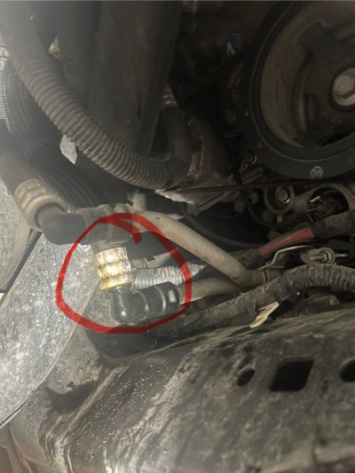

Hi Everyone,
Would you happen to know what this Hose is for? This is a pic from the front of the engine.
Thx!

I’m not sure exactly what Ford calls it but that’s the coolant line that runs from the engine to the transmission cooler.

There are 2. I had one leaking so went ahead and replaced both. Getting the old ones off was the hardest part. New just pop on, was about $300 for the two lines total.

It looks like you got the correct diagnosis. They are called TOC lines (trans oil cooler).
