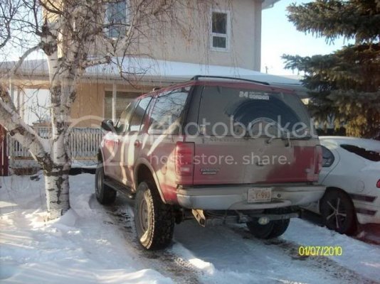

Sounds about right, your limiting factor is 2wd...for 4wd vehicles, you can squeeze 35's in the wells. Even with having 4wd, I stayed in the 33" range(295/70/17).
As far as which kit, they're all pretty much the same...however when you say Truxxx 3in, it's really a 3/2(if you get the right one) identical to the ReadyLift 3/2. All 4 coils get spacers. And they'll only work with non-air ride suspensions.
