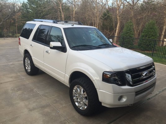

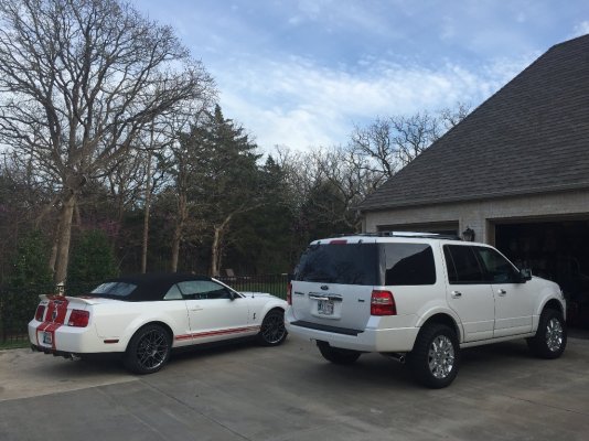

33/12.50/20
25631579363_ab4c672b0e_k.jpgIMG_1327 by limitedex, on Flickr
26141803752_00343e8662_k.jpgIMG_1325 by limitedex, on Flickr
25629521594_a371dd98ed_k.jpgIMG_0373 by limitedex, on Flickr

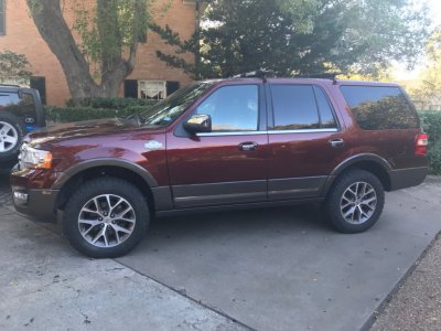

Posting my lift on 2016 4x4, FYI. Traxda makes a 2.25" rear, 2.75" front lift. I did not want it "leveled". I do a lot of towing. Don't want to shine in people's eyes.
For no extra cost, Traxda sent my shop a custom 2.25" lift for all 4 corners. I put BFG A/T T/A KO2's, 275/60/20 on. One inch taller tire. Total chassis elevation of 2.75". Just right for me.

That looks great Michael. I am still looking to do a lift but I don't think I want to go that high. Did you have to move or extend the brake lines for your lift? Did your mileage change at all?

I dropped it off and picked it up, so I'm not sure, but I don't think anything needs to be moved with this lift. Needs alignment and especially toe correction.
I've only burned one tank, but I'm guessing that my highway mileage dropped a bit when going over 65. I reset the computer (which reads about 7% better than what I calculate with gallons filled over miles traveled) at the beginning of the week. I got 17 or so at first, but when I got on the open roads doing 70, with no traffic (no wind break ahead of me) it dropped to 15. I don't think it used to be that bad. Pushing a lot more air now. Mileage really drops off at 80-85 on this vehicle (and yes, we have roads around Austin and in West Texas with those speed limits). I expected better.
Important thing with the lift is I won't get high centered in the ruts when the sand is soft at the beach.

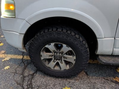

I got 275/70R18 Goodyear Duratrac's on f150 alloy wheels. Very meaty, with deep tread. Excellent snow traction thus far. Readylift quick struts all around.
