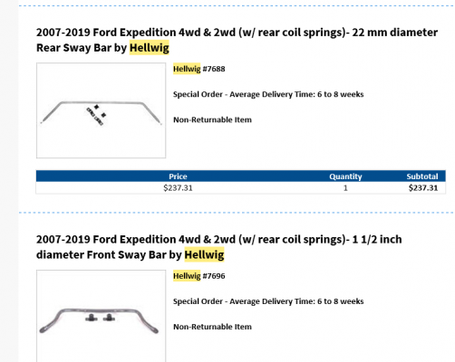

Hey all, looking to do the ready lift kit and sway bars for my 2018 Limited. I just wanted to confirm the part numbers of what I should be buying. Here's what I have:
ReadyLift 3/2: 69-2831
Hellwig Front: 7696
Hellwig Rear: 7688
Moog Front End Links x2: K750074
Moog Rear End Links x2: K750052
Am I missing anything? Is there anything else recommended? Next upgrade will be larger wheels when my tires are ready for replacement, which is relatively soon.
Thanks in advance for the help!

I can confirm the Hellwig #s. Here is my invoice from when I bought these. Also K750052 is correct for the rear end-links
Thanks for the confirmation. Did you replace the end links for your front sway bar or re-use the factory links? If you replaced, what did you use?
