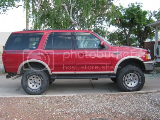

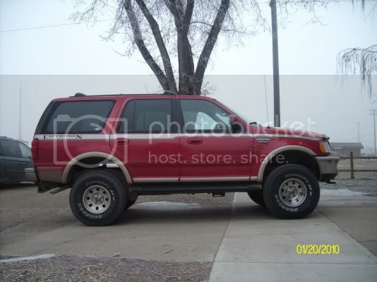

I have a 3 inch body lift, and you can't see the frame. Just make sure you buy the Performance Accessories Gap guards too or you'll notice lots of frame in the wheel wells.
Without Gap Guards.... Lots of frame:
With Gap Guards.... No frame:
