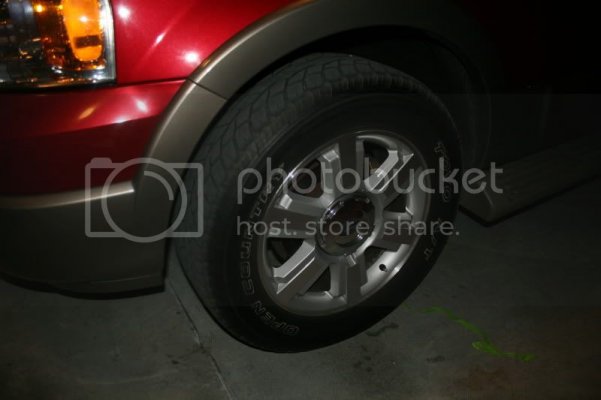

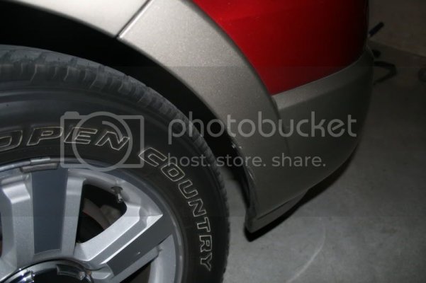

Well I picked up a set of OE 20's from an F-150 FX4. The guy I bought them from has 275 60 20 Toyo Open Countrys. Without any lift, my 2WD fits the 33's. The only rubbing I have is at full steering lock the tire rubs the sway bar a bit on the backside. I was suprised they would fit without the lift. I know I know I need to post pics...

Wheels and tires look good on there and it looks like you have a fair amount of room to work with. If those wheels were spaced out a bit more you wouldn't have the rubbing problem, but then they would probably be sticking out past the factory flares. That's what I did, 18x9 wheels but they stuck out past the fenders a good bit so I got aftermarket flares.

thanks. these tires are pretty worn. I was thinking of going with 275 65 20 next, thats a 34" tire. I think that would fit as is, but I would probably get a 2" lift for added suspension articulation.

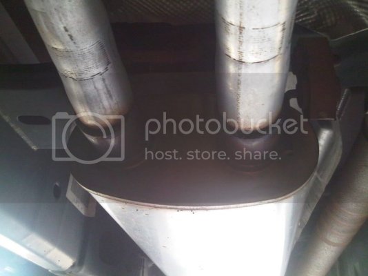

Just wanted to chime in here real quick. Just finished installing the TRUXX 3/2 lift on my wife's 04 Expedition an it really made a difference. Definitely recommend it.
As for the "true dual exhaust", just did that as well. I boughta Magnaflow dual-in/dual-out muffler and had a muffler shop cut out the Y-pipe and run both pipes back to the Magnaflow and then ran two pipes out the passenger side. That made a huge difference as well.
did u use an x-pipe before the muffler. I have heard that you need to do that cause the pipes are different length. I am suprised they had room to run 2 pipes on the same side, my single 3 inch was a bear by itself. Love to see pics if you have them too!
Rptr00,
The dual-in/dual-out Magnaflow mufflers have a built-in X-pipe so an external one was not needed. With regard to the tailpipes, I did have to step down to 2.25" pipe to make it all go around. Will get some pics next week and try to get them on here.
nvycrmn,
Running both out the same side was really the only option. The gastank prohibits you from running the pipe out the driver side prior to the axle and the spare tire is too far to the left to run it out the driver side to run it over after the axle. My intent with running true duals was more for performance than appearance.

Oh, I didnt realize it had the built in x-pipe. maybe thats something for me to try later on. I really hate the stock y-pipe, very restrictive.
boiler71
May 9, 2010
94
Tampa FL
Very restrictive indeed. That muffler REALLY opens things up...and has one hell of sound when you get on it. Relatively quiet otherwise.

Finally got my wife's Expi up in the air for some pics of the dual exhaust. Hard to see the two pipes going over the rear so I did a before and after the rear end.

nice. I want to eventually try something like that except I will do dual in and single 3" out
