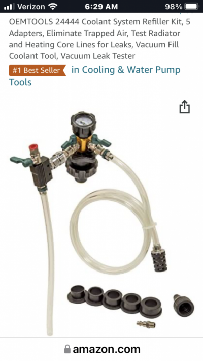

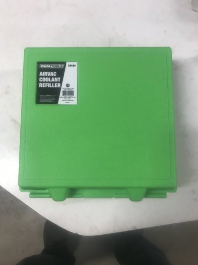

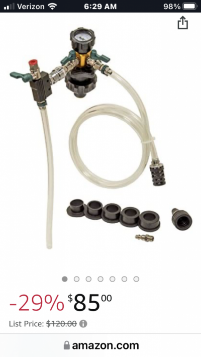

I just bought a coolant evacuation tool to use on both of my 2017 Fords (Expedition and Explorer) to change out the orange coolant over to the new yellow. My Ford tech buddy told me about the tool and how it makes it simple not to get an air lock so I ordered it on Amazon. I’ll be able to use it on my work trucks also, so I justified buying it.
Boostedbus
Mar 1, 2018
747
465
Maryland
Nice find can you give a link to the tool?
I forgot how to attach a link so I just screenshot from my Amazon cart. There’s another brand that was about half the price but the reviews said it was prone to leaking. My Ford tech buddy says you connect to your system from radiator or recovery tank, connect your compressed air line and it pulls a vacuum on the system totally draining it out one of the hoses on the tool. You can also see if there are any leaks in the system if the vacuum does not hold once you unhook the airline and shut the valve. After it’s drained and the system is still under vacuum then you stick the hose on the tool with the sump screen into a bucket of the new coolant and open that valve. The vacuum will pull all the new coolant back into the system and you are done. I just received it so I’ll let you know how it goes when I get around to using it hopefully in the next week or so.EBAC9965-7FEC-481E-AC5A-15EDE5EAEC92.pngACDA2554-31EE-4164-93B2-40BEC0B95563.png

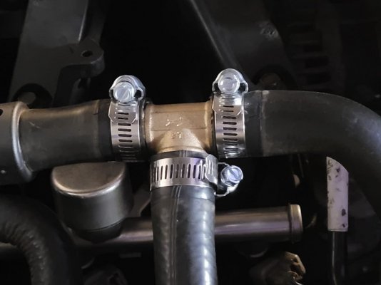

TL/DR: coolant hose leak at T (tee) at high RPM only - replaced T after cutting/removing the plastic part and replacing it with 3/4" tee from Lowes/home depot for 5 bucks and secured it with original tubing with 3 hose clamps ($2 each). Done! Pic attached.WhatsApp Image 2022-02-28 at 9.56.00 AM.jpeg

- After a few weeks, the engine heated up (shown on indicator), car slowed down and came to a stop, with coolant leaking on the road. Turns out, there was a loose connection of hose with the radiator. A strong push on the hose by holding it in hand and jabbing it towards radiator gave click sound, and the coolant is not leaking any more (in the hind sight, the mechanic must've not pushed it hard enough after putting the radiator back on after engine replacement)
- After a few weeks, the dreaded blinking engine sign came back on, immediately after high RPM (on the freeway, Expi was on cruise control, and tried to get back to set speed after a slow car in front changed the lane, leading the tachometer show the engine going up from 1 krpm to 5 krpm!), and soon the sign disappeared, P0304 displayed on OBD, and coolant was visibly lower level on the reservoir.
- Brought Expi back to the mechanic, he opened the hood while the engine running, asked me to press gas pedal hard, and as the rpm increased, there was a leak spray from the T (tee) junction of the hose - this spray was basically drenching the passenger side head (pistons 1-4)
- Removed the plastic T (tee) by cutting it with dremel, making sure not to cut the hose, and replaced it with a brass 3/4" T from Lowes (see pic). No more leaks!
- Blinking engine sign kept coming at multiple instances after high RMP (>4 krpm) with P0304 on OBD - so replaced the spark plug and the coil (for free, from the extra coils and spark plugs salvaged from the older engine, remember?), and now car doesn't have any issues after months of driving! (so far...)
- In the hind sight, the leaking of coolant on the engine might have been happening for a while, and has water damaged/shorted the coil (P0304) and leaked to the spark plug (seals of the coil are not perfect) and might have caused differential temperatures on the engine leading to valve malfunction and the spring of the valve shotting in the combustion chamber and damaging piston (P0302)
- The plastic T (tee) and Y (yee) connections, and any plastic parts on the coolant piping should be replaced with metal, as plastic might eventually give up (oxidized, brittled, and eventually leaked or a full-blown crack). I saw a lot of black residue on my coolant reservoir, which felt like gooey stuff from molten plastic, and am pretty sure it came from the T (tee) that failed and was leaking - basically it seemed that the hot coolant was melting this aged piece of plastic!
