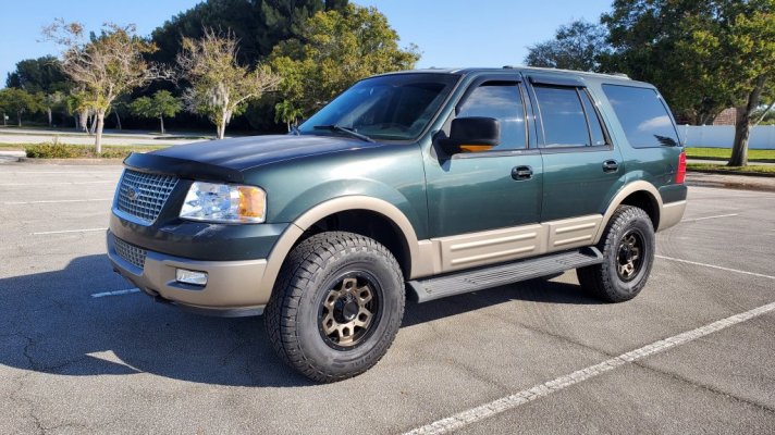

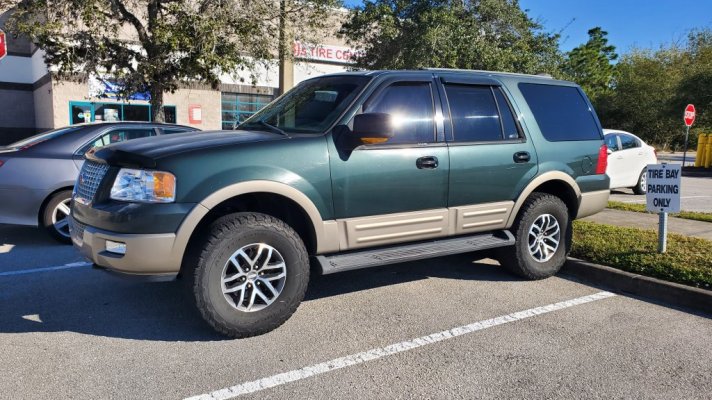

I've been running the Daystar 2.5"/2" lift for over 6 years. It's hard on the front upper control arms bushings at the frame mounts. I've replaced the Moog arms twice (i.e. on my 3rd set), but with lifetime warranty, it's only my labor. I added a spacer to the rear struts so that made the lift pretty even about 2.5" all around. I've been running 35" tires (315/70R17, they're actually 34.5") for the last 3 years. I started with a take-off set from a 2016 Raptor. That was a great tire/wheel combo. The inside tire wall would rub on the lower control arm at full turn lock, and would barely touch the corner of the front bumper valence at half turn (I trimmed 1/4" and it was good). It still fit in a standard house garage. I don't think performance was affected too much, but these aren't quick anyway. I bought a used programmer (Hypertech 42000) so I could recalibrate the speedo for bigger tires. I also programed it for premium gas, but I don't think that did much either. Six months ago I replaced my strut assemblies with Rancho Quicklift assemblies that add another inch of lift, so now I'm at 3.5". I think it will still fit in a standard garage, but I haven't had the opportunity. I bought new wheels and tires. I wanted just a little less wheel offset to push them outward just a little more. I also bought one of the most mild tires I could find because I never go off-road. I'm very happy with everything now. There's no rubbing, it still rides great and the Continental Terrain Contact tires do great in FL rain.
