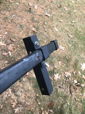

I fabbed up and powdercoated some simple brackets out of angle stock that let me clamp thule square bars directly to the stock rails. It's about as low profile as you can get.

Sorry, no pictures on the car. the brackets bolt to the holes on the inside of the stock rails. When I have it on the car I have a thule box on it, so wind noise is really driven by that. It's 8 simple 10mm bolts to take off, so I just take the whole box/crossbar/brackets off as one piece when I don't need it.

I gotcha now. I have been thinking about something like that with custom cross bars out of tubing. I hate the look of the big rail clamps I have. But I have settled for the taller rack because of the noise and snow. It still sucks to clean the moon roof and lube the gasket unless I take it off.

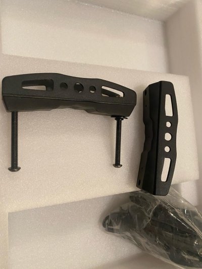

I think most people that have had trouble fitting their roof racks try to order theirs online. I went to an actual rack store where that’s all they do is roof mounted baskets, racks, rocket boxes,tents and awnings. They have all the parts and know what fits. I used the Rhino Rack universal mount that came with my rack to mount to the factory crossbars.
Picture of the piece that goes under the factory crossbars

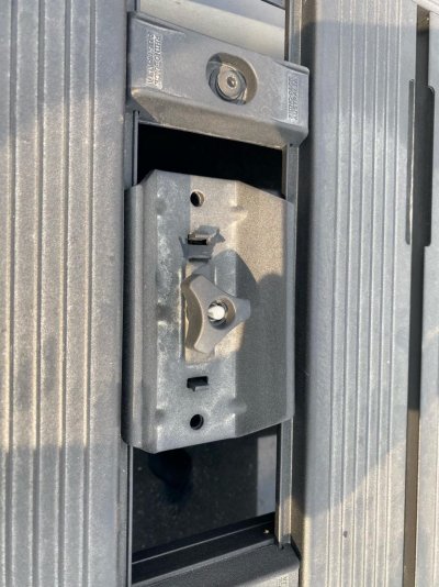

Picture of the top mount. In this picture I have reused the top mount and it is now in a T-slot on my HD bars. When mounted to the factory rails the two long bolts went through the outside holes and into the mount pictured above.
