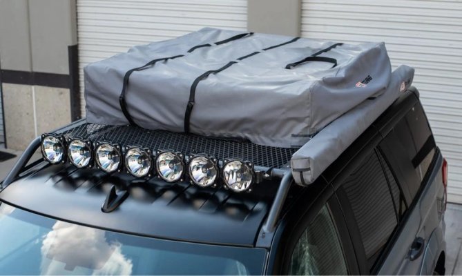

$1999 for just the rack. No lights. No tent. No awning.
My Eezi-Awn platform rack was around $1100. Expensive. But well worth it. In 10 years when I’m done with my 2014, the rack will be removed and transferred to a new vehicle (the 4th vehicle it’s been installed on)- or sold for several hundred dollars. Buy once, cry once.

$1100, not $1999 for the rack only...
I get buy quality and not junk.
If somebody was looking for an extreme rack, $1999 might be in their ballpark.

The LGE will only transfer to another Gen4. If they change the body style it will be no good. So at $1900.00 with out anything but the tubing. It might not be worth the investment. I love the look and would have one if I didn’t have the moon roof. Already sucks to service with only half covered.

That doesn't bother me. I like the integrated "stock" look that it provides. I keep most cars 10 years or so. By then, I am sure there would be other things available or roof lines will be different enough that something I bought today would not fit my next vehicle... At least that seems to my luck with purchases. LOL
