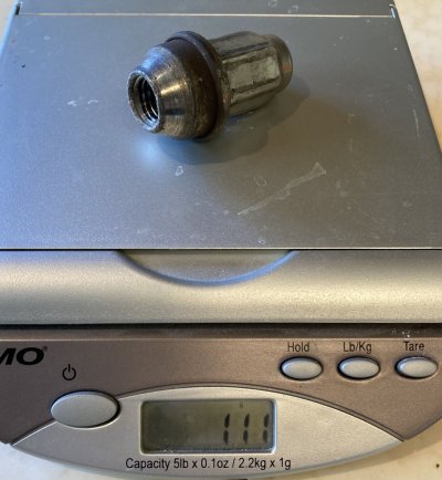

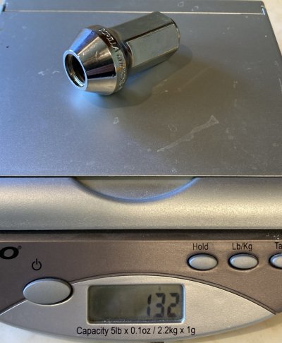

Here are some weights for those interested...
